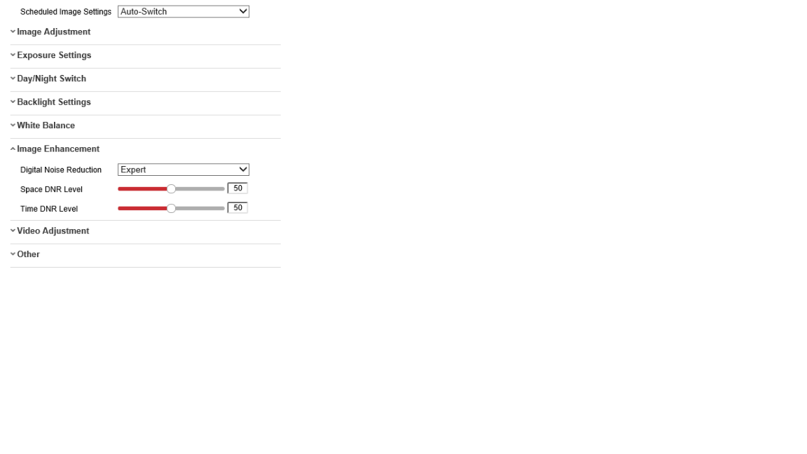

Post a screenshot of your camera's encoding settings.

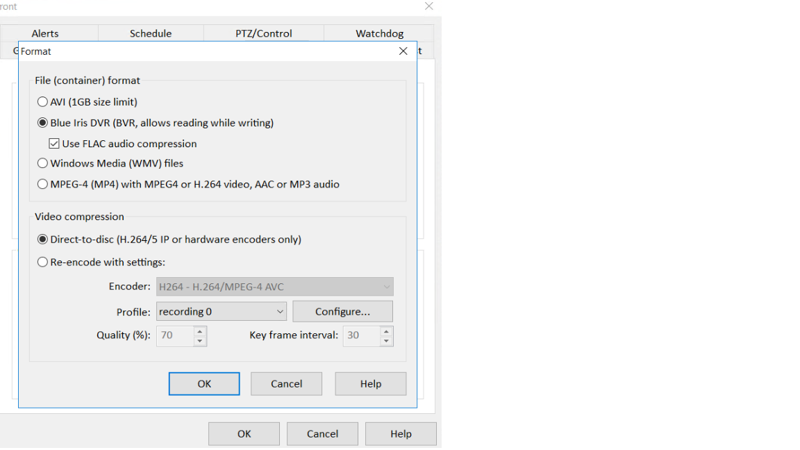

Also make sure Blue Iris is set to record the cameras using "direct to disc", otherwise the stream is re-encoded and quality gets worse.

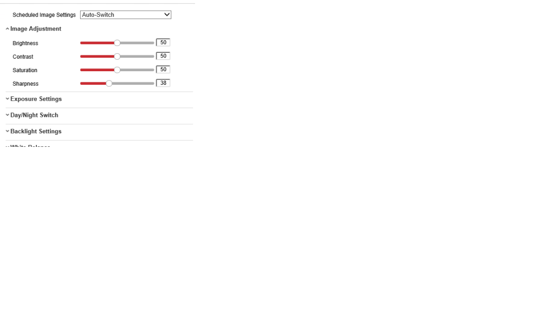

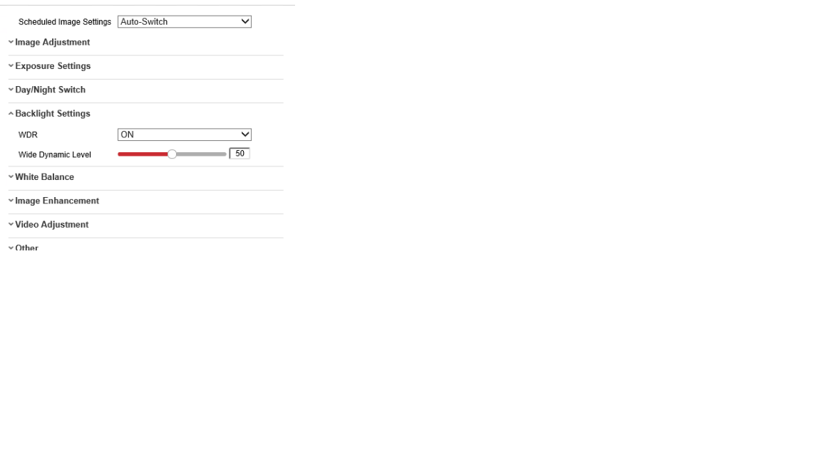

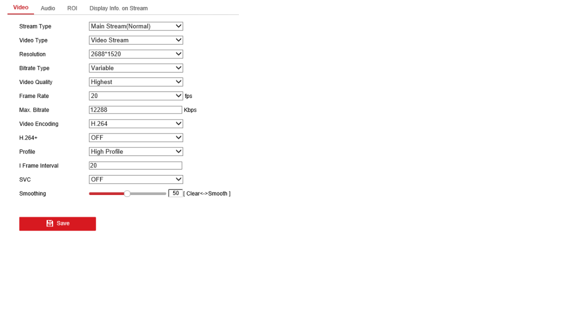

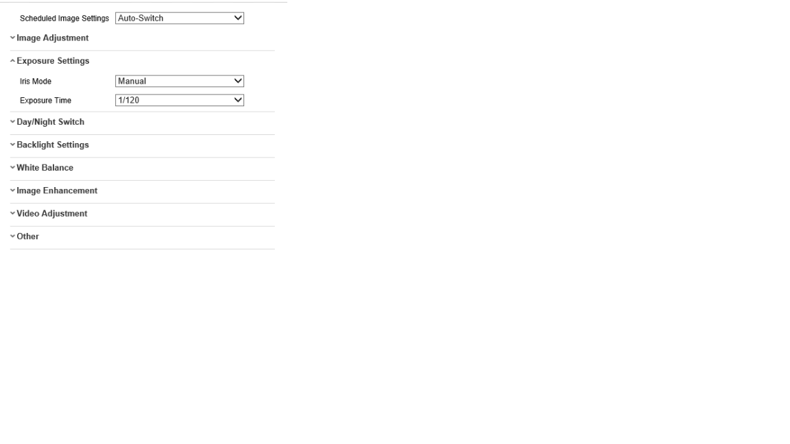

Thanks, attached are the settings I have.
I do have BI disk to disk.

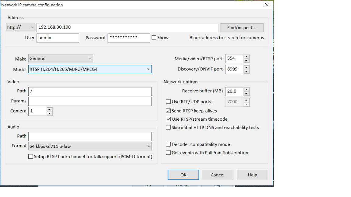

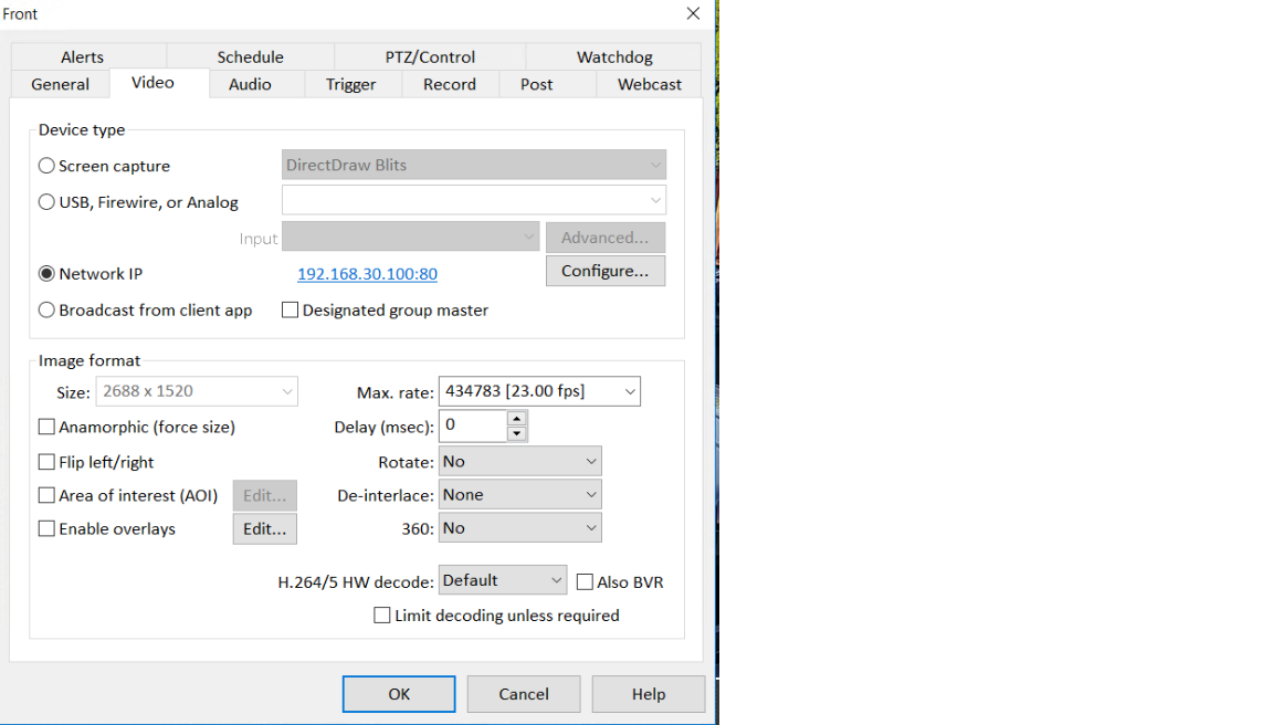

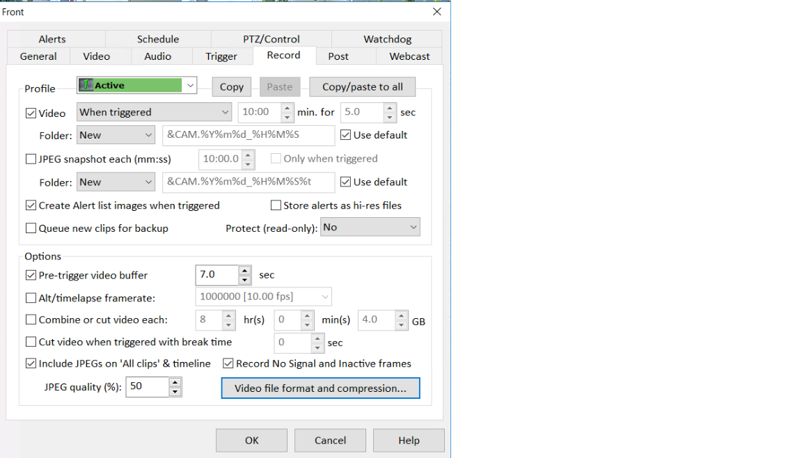

We need to see the Camera Settings that you have setup in BI, not those you provided.
Sorry.
See attached..
Let me know if you need other settings..
It might help to know what camera/lens is being used and at what distance you are trying to recognize a face at. Look in the WiKI at the top of the page and read the "Cliff Notes". Lots of excellent information regarding lens versus distance for facial recognition. Remember, too, that when you zoom in you are digitally enlarging the pixels themselves. Too few and pixelation will spoil everything.
