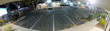

I have a Color4K-T180 camera both in front and behind my house. I think they work great. I grabbed a few clips here for you to see. In front of the house the camera's lights are off--only a single streetlight for illumination. This was during a wind storm this week, so sorry for the loud wind noise. For the T180 in back of the house, the area is completely dark at night, so I have the warm LED lights of the camera turned on. Last night the fog was rolling in (I'm 10 miles in from the ocean), so take that into account. The image is usually very clear on a good night.
Amazing, thank you both. You really can't see a seam between the images. It's frustrating that the T180 doesn't have IR, though.

my picture above was a PTZ3E10X-T180. Not too shabby. It is a 2 channel camera: 180 view for channel 1, and PTZ for channel 2. Does have mic, speaker, red/blue LED's. Does auto-track humans (not vehicles with current firmware).
Not too shabby of a multi-cam unit.
For my purpose, the optical 10x's works for me as not needing 50' distance views.
I have good lighting in the neighbor hood so the smaller sensors work great here.
I use the PTZ to keep eye on packages with presets and alerts that I monitor from DMSS, SmartPSS lite, and also Blue Iris.
