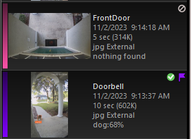

Curious if you are using Artificial Intelligence on your Trigger qualifiers? You may be getting a triggered event but running it through AI before the alert is sent. And if this is the case then if AI doesn't meet the conditions required to send the PushOver alert you'll never see it. The best way to check this is look at your alerts. If "nothing found" then no PushOver alert if this is how you have it configured. See below....top one, no PushOver alert....bottom one, yes.
No, AI is disabled on that (and most of my) camera(s). I think Jay is right about the database. It's been a long time (and lots of updates) since I've last regenerated it. That may also explain why the problem got progressively worse over a two week period of time. It was very inconsistent.

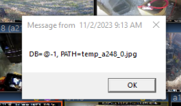

Just noticed the &ALERT_DB macro is resolving to '@-1'.
I saw that recently when my database was corrupted by v5.8.0.9. Maybe time for a DB/Repair or DB/Regenerate?
You're a genius. That was it. Deleted the DB folder under c:\blueiris and rebuilt. working like a champ now. TY!
Reactions: jaydeel
Just curious, we're you running v5.8.0.7-5.8.0.9 at some point the past week? Many of us lost all of our recordings running one of these. This is when I first noticed the DB returning record ids like '@-1'.
No, I was actually running 5.8.0.3. I just bumped it to the latest (5.8.0.14). I know, bleeding edge is asking for issues, but I'm a gambling man. I hadn't updated in a while since I was relying on the prompt of a newer version - and at some point I disabled the prompt.
That said, running .14 now, I get this:
So the @-1 appears to be the new norm.

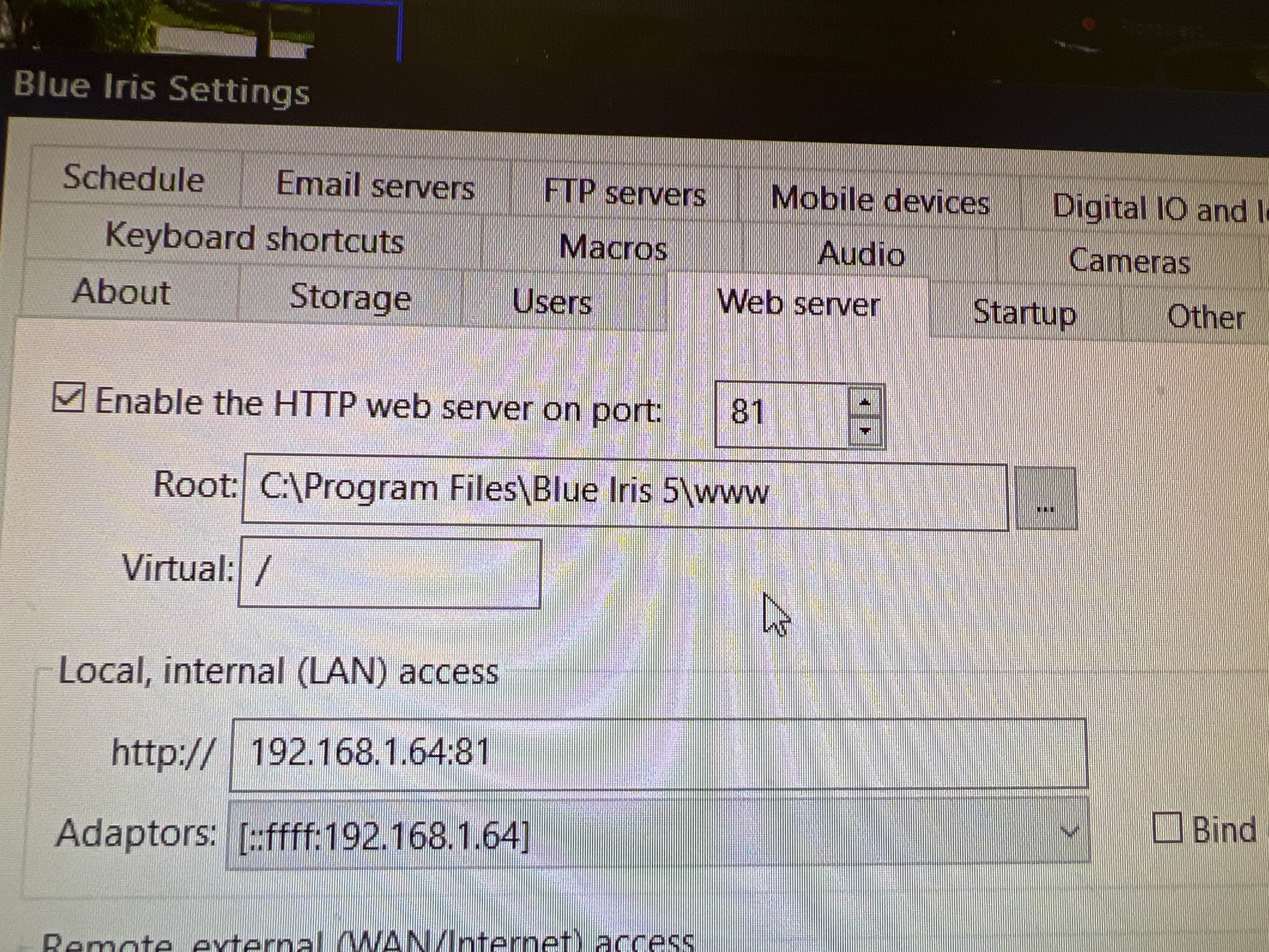

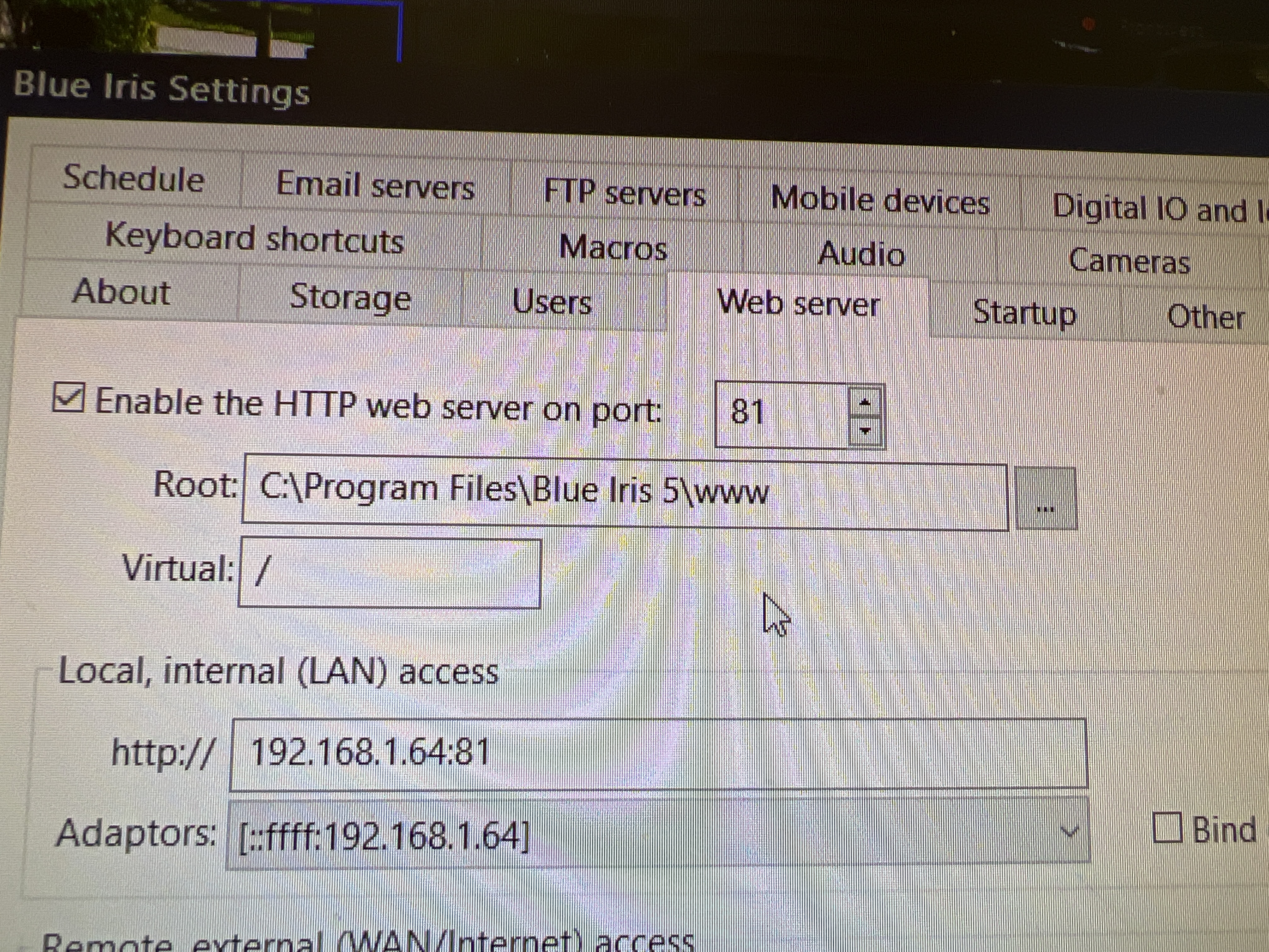

The port is included already, see screenshot. I’m trying to force it open in Chrome but you can see the http:// is not changeable on the web server tab. Although I’m not entirely sure if the &LAN adds it or if it pulls it from that field.
I can access ui3 fine from Chrome. I’m just trying to be lazy and have the link open it from pushover without changing the default browser to chrome.

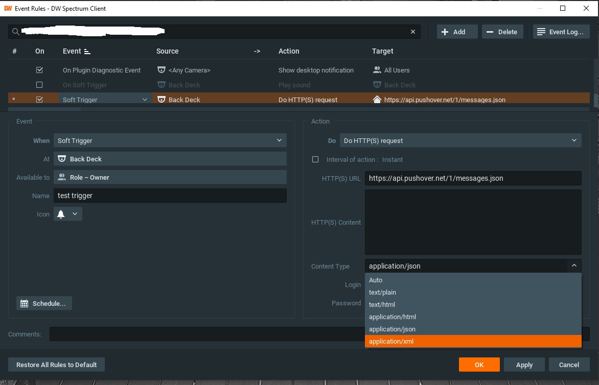

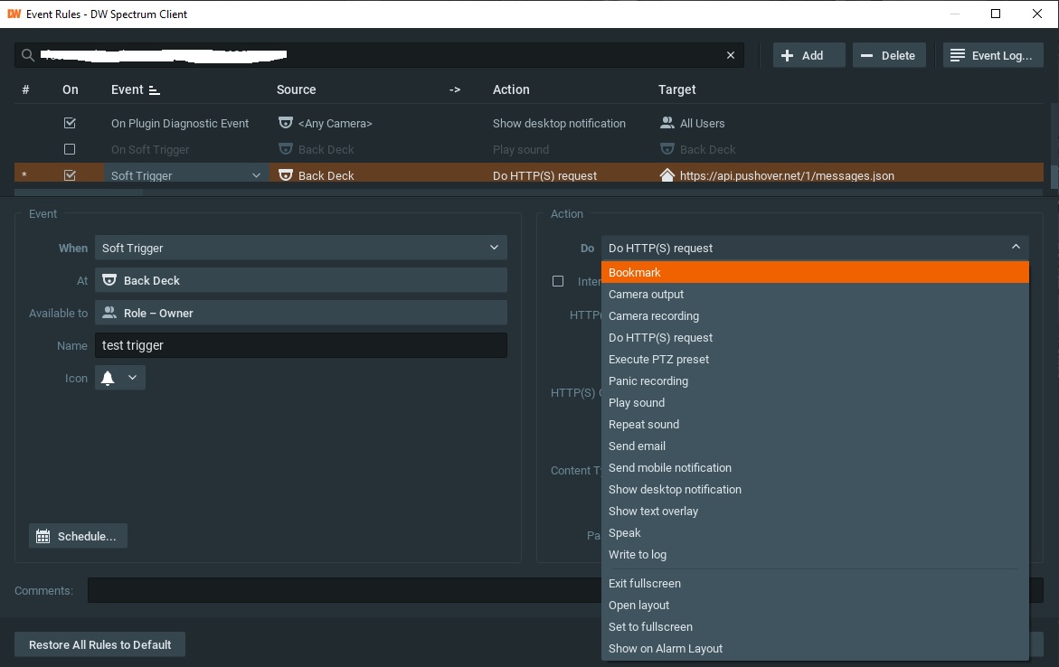

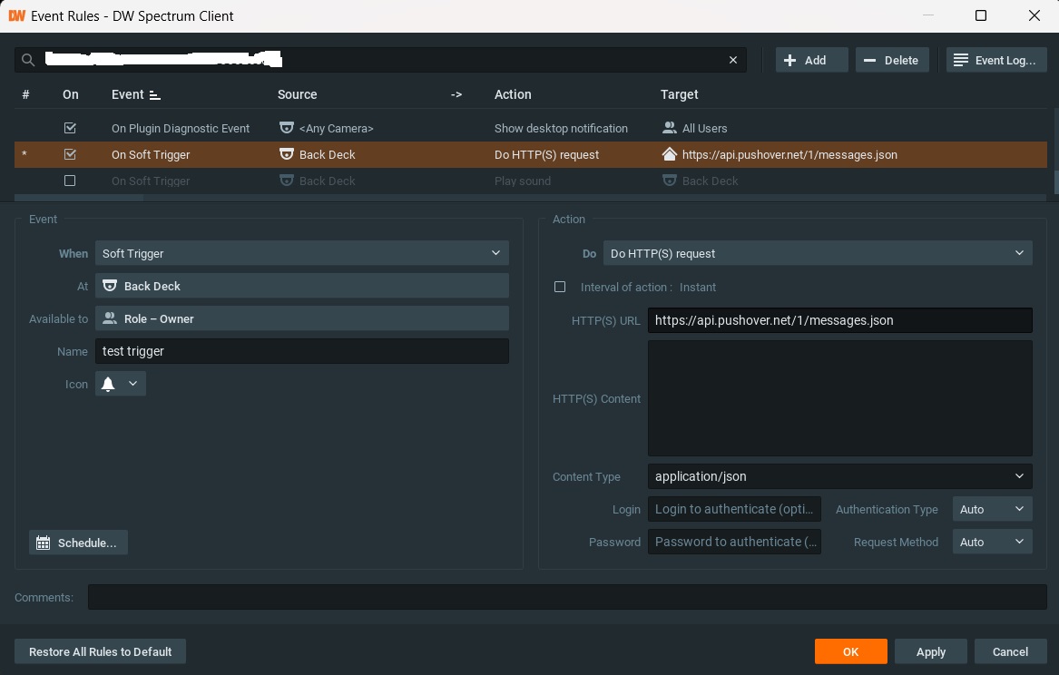

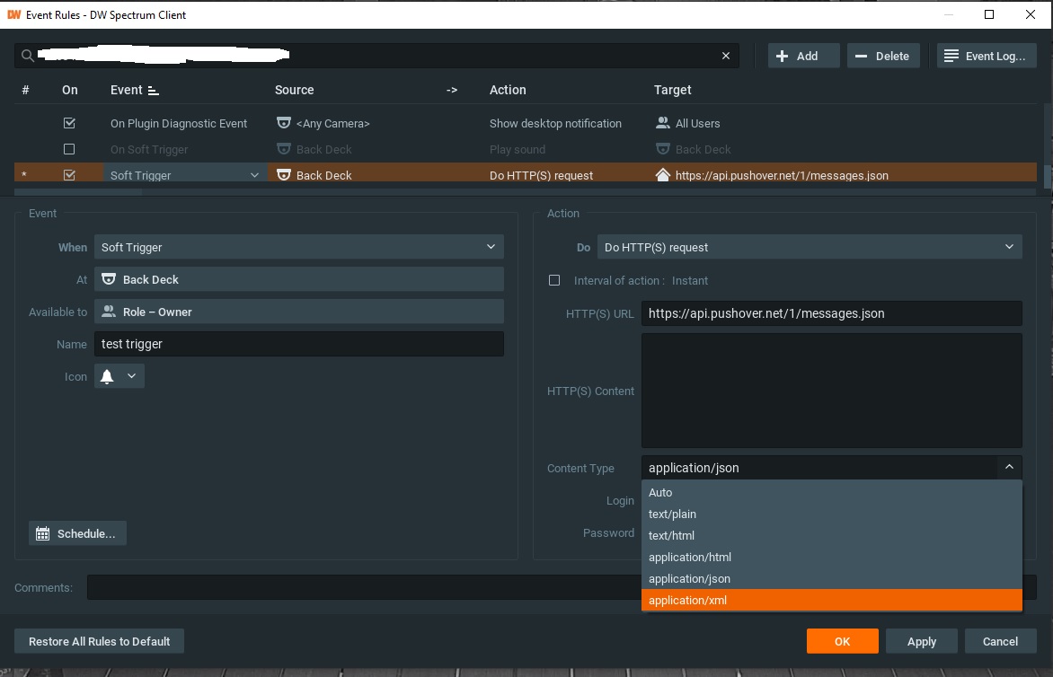

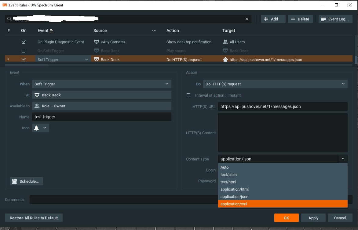

@jaydeel I'm attempting to setup pushover notifications using Digital Watchdog. DW has an option called Do HTTPs request and it can be activated upon an analytical event trigger. I've tried a number of combinations and I've also read Pushovers API page. I just can't seem to figure it out lol. All I'm trying to do at this point is get DW to successfully send me a pushover notification which only includes a simple message like "test". DW has a feature called "bookmarks" which is similar to BI's alerts. Once I get DW to send a successful Pushover then I'll figure out how to grab the bookmark image. I've included my token, user and message in the link. I think I'm just not typing it in properly. Assuming I continue the line in the HTTPs URL field, how would I continue it after "messages.json'"? Do you have any suggestions?
I made a cursory, unsuccessful attempt to find a user guide for your software.
Does DW have an option to send a curl command?
If not, how about to run a program/script? If affirmative, here’s a basic PowerShell script I previously posted that you might find useful for testing.

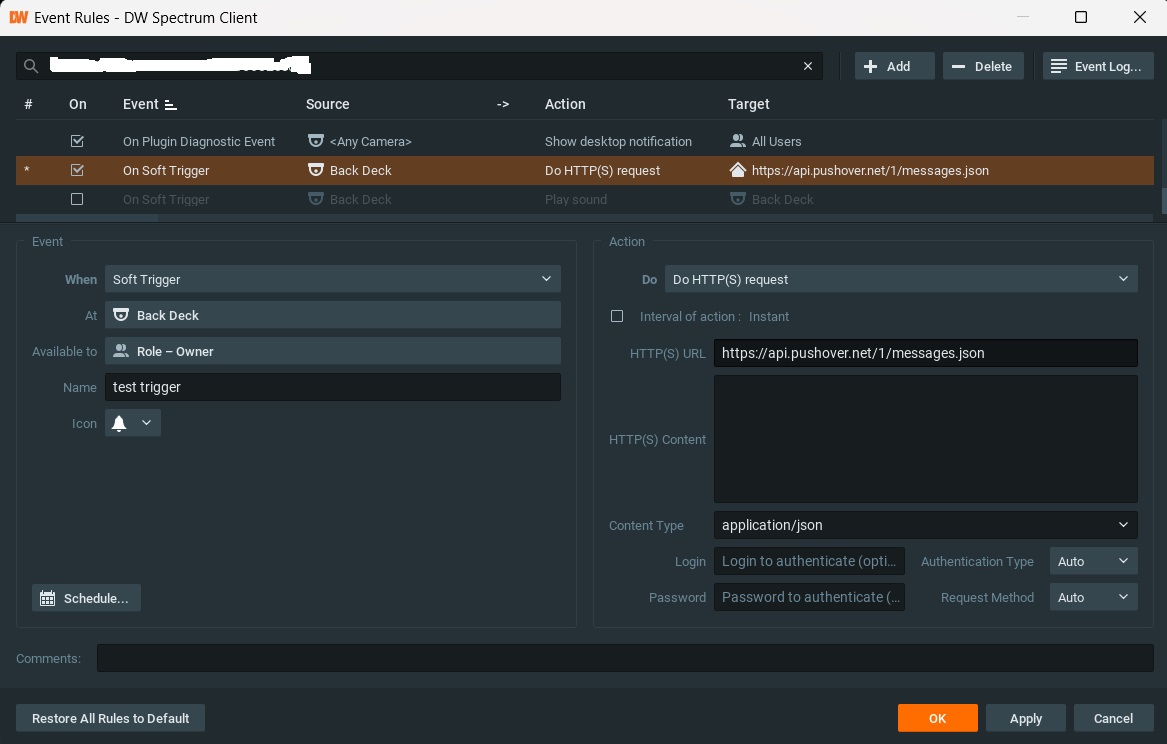

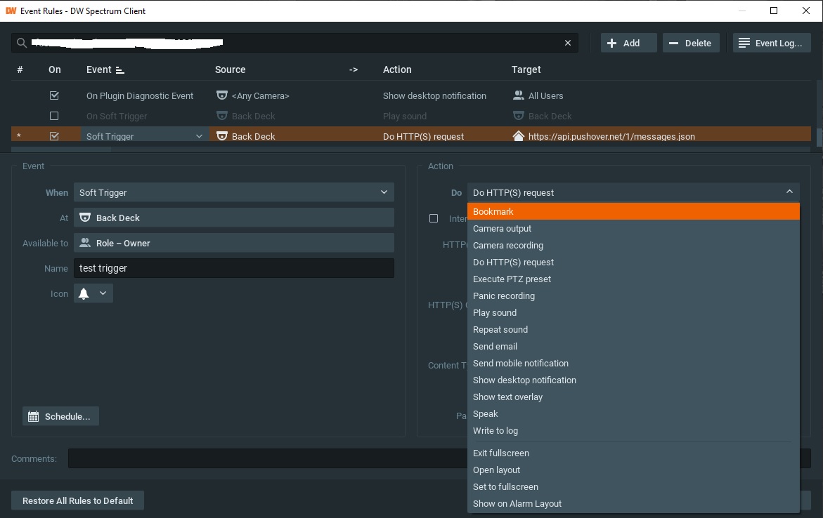

No, only option is to do a HTTPs request. I attached a picture with all of the options.

The email option works, I was just hoping I could get it configured where I could send it directly to pushover without having to use an email address and have a bunch of emails in my "sent" folder. Worse cause I will just use the DW app for push notifications. Only problem is I can't change the sounds on DW app and I like the distinctive sound of the pushover alerts.
Sounds like a crappy app/server software. Blue Iris for the win! I'm sure @fenderman would get a kick out of that lol.
