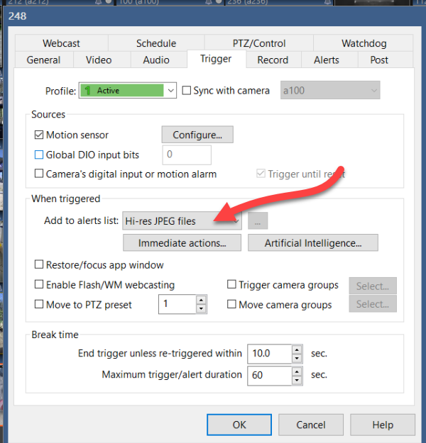

I just wanted to concur that once you have it configured correctly, it is wonderful. If you're not proficient with command line stuff, it's a bit of learning curve. But it's worth the effort. I had to push through.
One step I missed that caused me all kinds of grief was turning on the high-resolution image (vs database) under trigger:
If you miss that step, you will be beating your head against a wall...

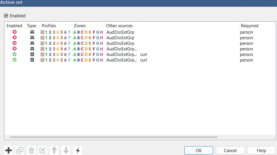

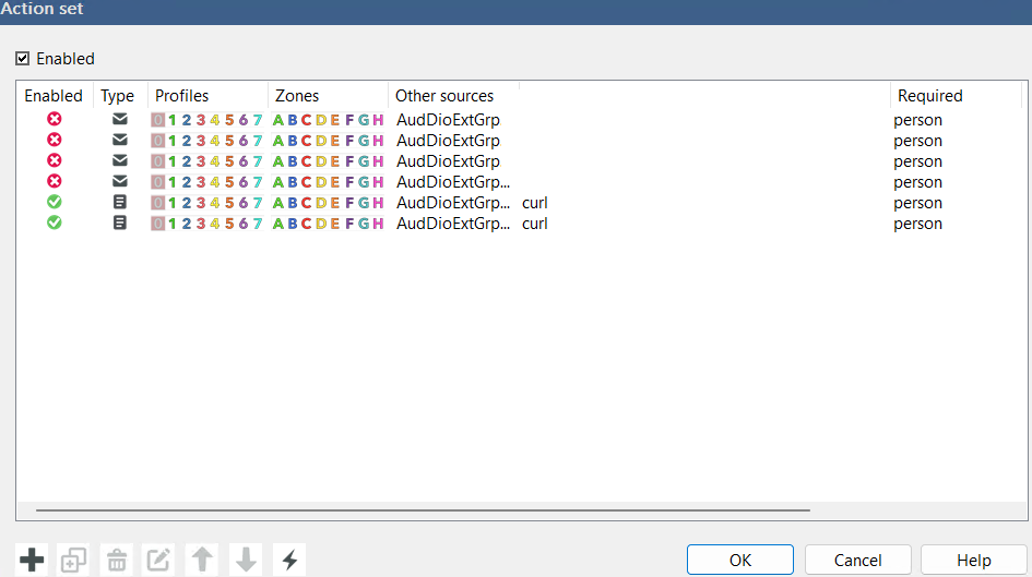

I wish blueiris author would implement this natively instead of having to write out the command. Also, why are there no labels for the ALERTS I am running? I have a few pushover accounts and it tough to decode which one I am sending to without a label on the alert section (unless I somehow missed it).

When you say "no labels" I'm not sure what you mean. I get the camera name in my alert list on the pushover app on my phone using the curl command.

By labels. I mean the alerts area. I attached a photo. All I see for description is CURL. Id like to label it but not sure if im able to
