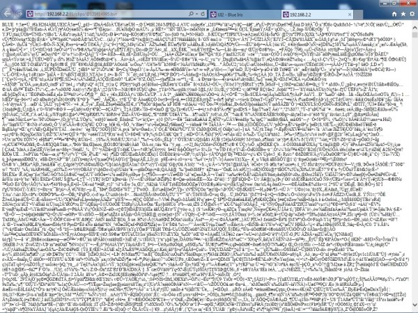

When I use the download option from the clips pane on the left, I always get a new tab just filled with code, see picture.
I was looking to create an auto update script with powershell and I was wondering what method you used to check to see if an update was available?
When I use the download option from the clips pane on the left, I always get a new tab just filled with code, see picture.View attachment 23801
Internet Explorer apparently has trouble with this. Blue Iris doesn't specify the type of content being sent, so IE interprets it as text instead of a file download. I've asked if this can be fixed in Blue Iris.

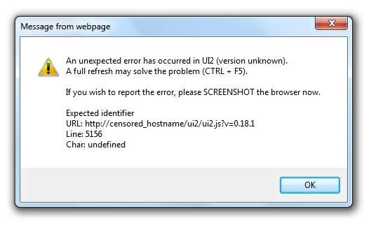

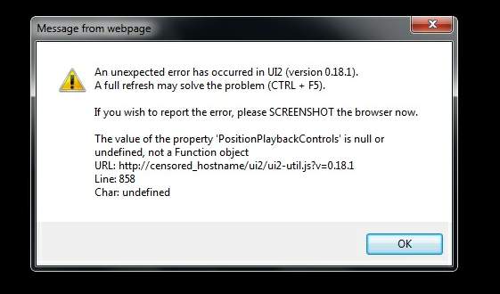

Any idea what is happening here. I get these error messages using IE on a Win 7 laptop at work. However, Firefox works fine. Once these errors happen, the machine is stuck and Task Manager is the only way out. Thanks.
Your IE is probably trying to use a compatibility mode which makes it emulate an ancient version of the browser, and that ancient version can't handle the script. I don't know why some people's IE does that.
The second message is coming up on mouse move so if you move the mouse out of the window and use the keyboard to dimiss the message then you shouldn't need to use task manager.
