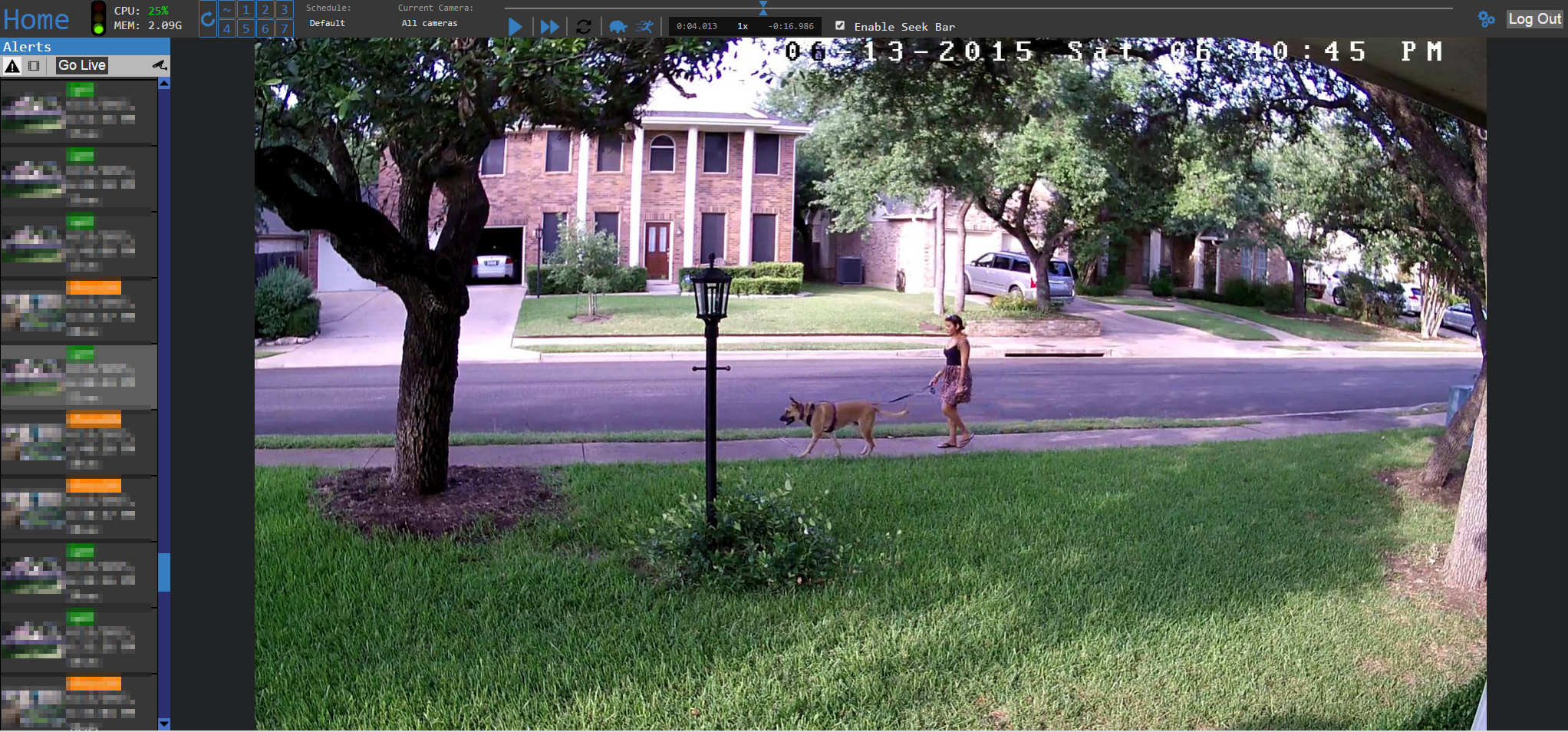

I really like the new control bar and the option to place it at the top or bottom of the screen. However in either case it overlays the video. For those of us with larger widescreen monitors and a long thin band of unused space at the top of the UI2 interface, is there any chance of having an additional checkbox option to move the control bar to the top in the blank area to the right of the "current camera" selection, like this:

Yes, @piconut. I will try to make that work. I don't particularly like having it overlaid on the video either.
It just occured to me that the top bar area would not work when the user has selected the fullscreen option, so maybe there is a way that when fullscreen is selected, that the control bar shows up and disappears like the VLC controls do when you play a movie. So when you hover over the bottom of the clip, the control bar appears (in full screen mode) but otherwise there is an option to show above the clip in the top bar when not in full screen view. Just thinking out loud....
