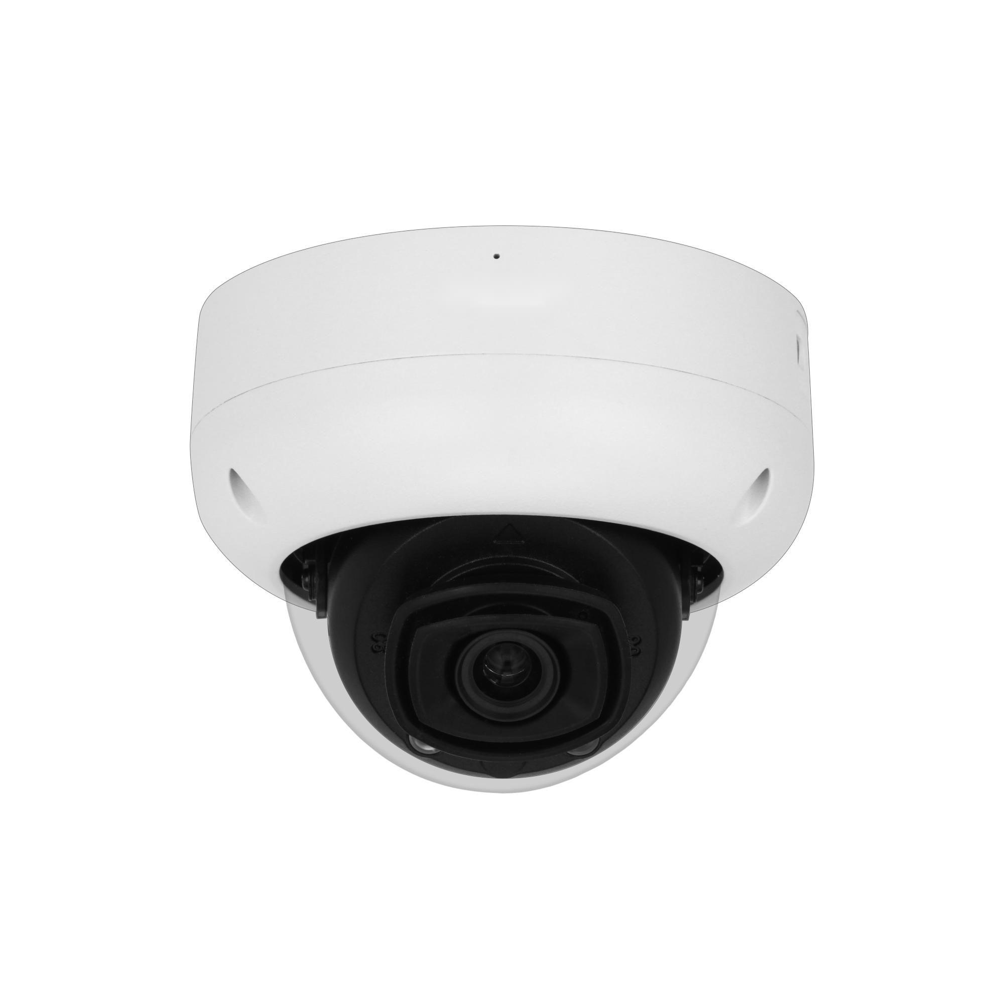

do you have any recommendations on what I should swap them out with? Perhaps Andy product?
Andy’s products are Dahua with his sticker
So yes.
Depending on the scene and purpose, lighting, distance, etc.. there are many to choose from
The current favorite is the 5442 series
Same camera in dome
Newer models are being released in a few weeks but unless you are ok with white Spotlight LEDs being on all night, limited benefit
