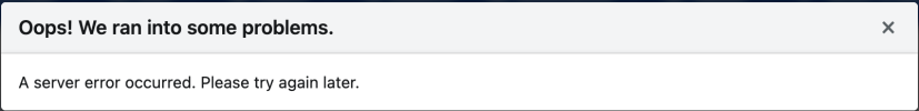

Yeah it’s happening to everyone.
I find just ignore the error, x out. And hit refresh.
Each time you accept the ooops message and try again it’s stuck in a posting /error loop
Reactions: Looksee
Sorry for the multi-posts. I didn't know because an error message popped up each time so I tried again.
edit: It happened again when I posted the above.
2nd edit: Won't let me delete dupes to clean up. I'll try to do that when the prob is fixed.
