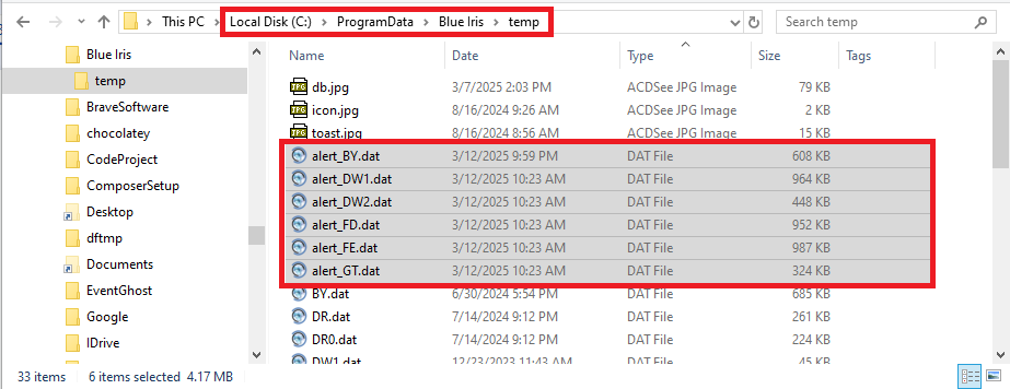

Ken previously said this was doable. Notably, Blue Iris already grabs JPGs from the buffer for AI processing (and, saves them to the DAT file, if configured). All of this apparently happens before the the alert is triggered, and the buffer is written to the BVR file. I'm pretty sure this is why using the DAT file always works.
